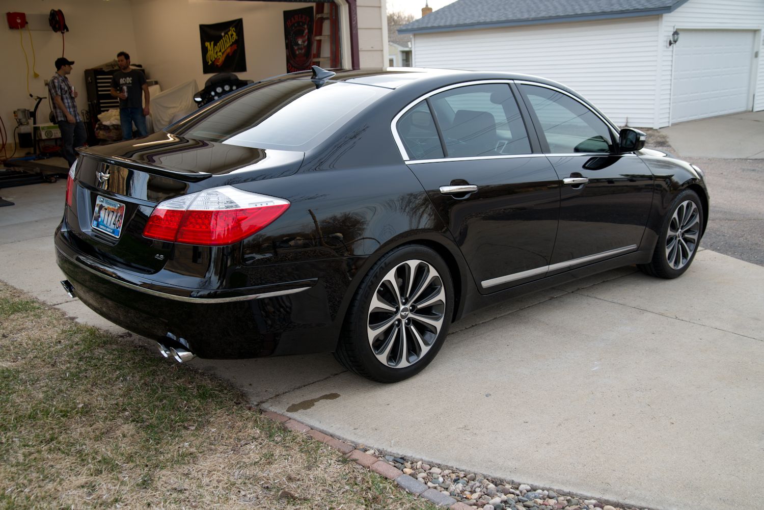

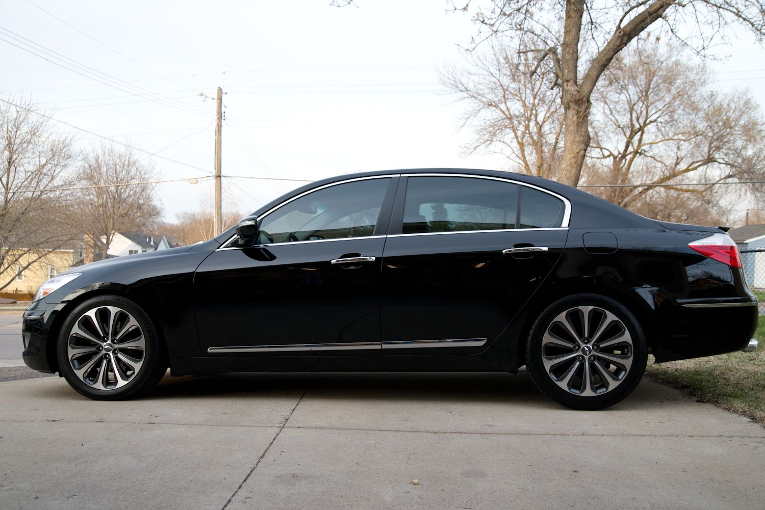

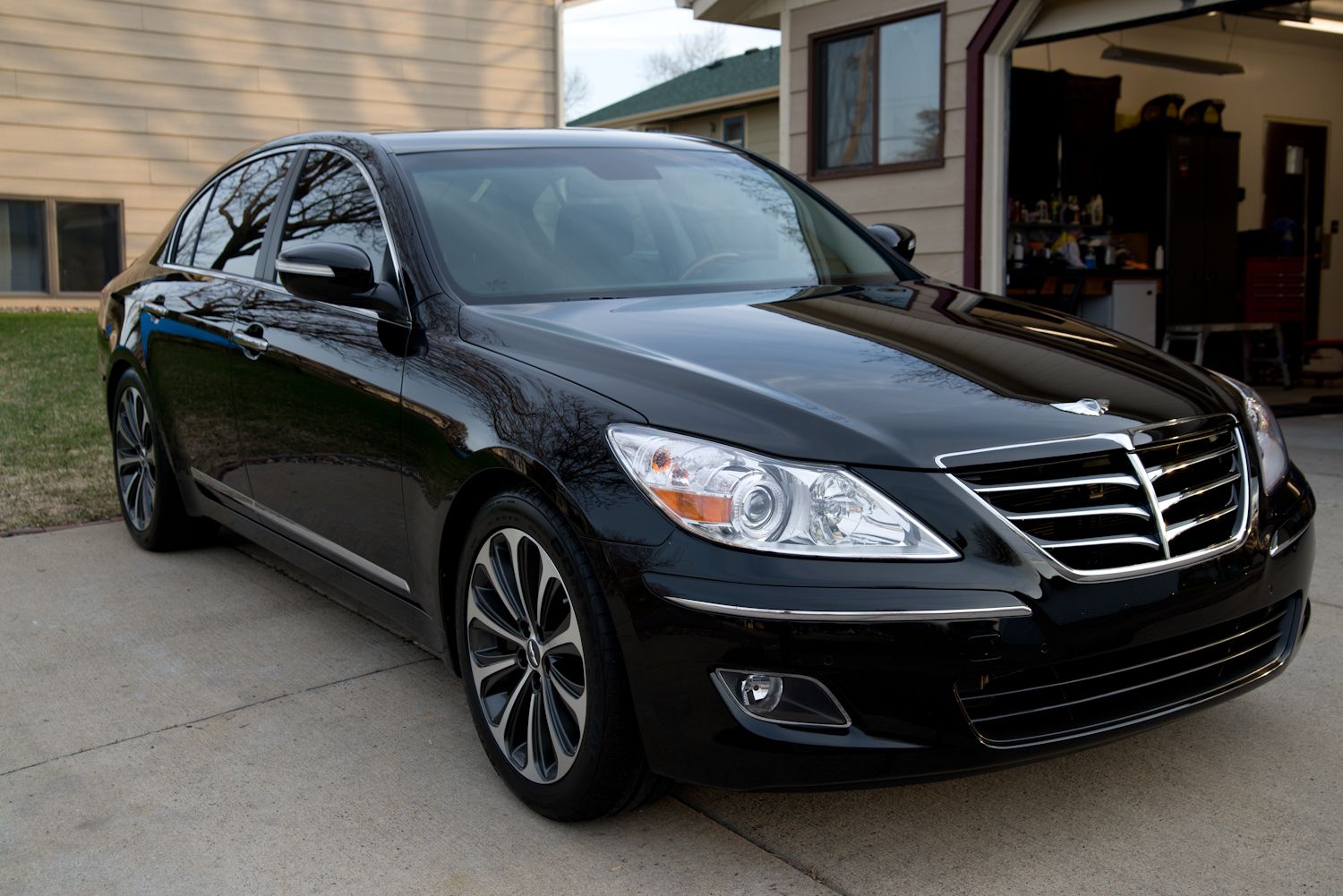

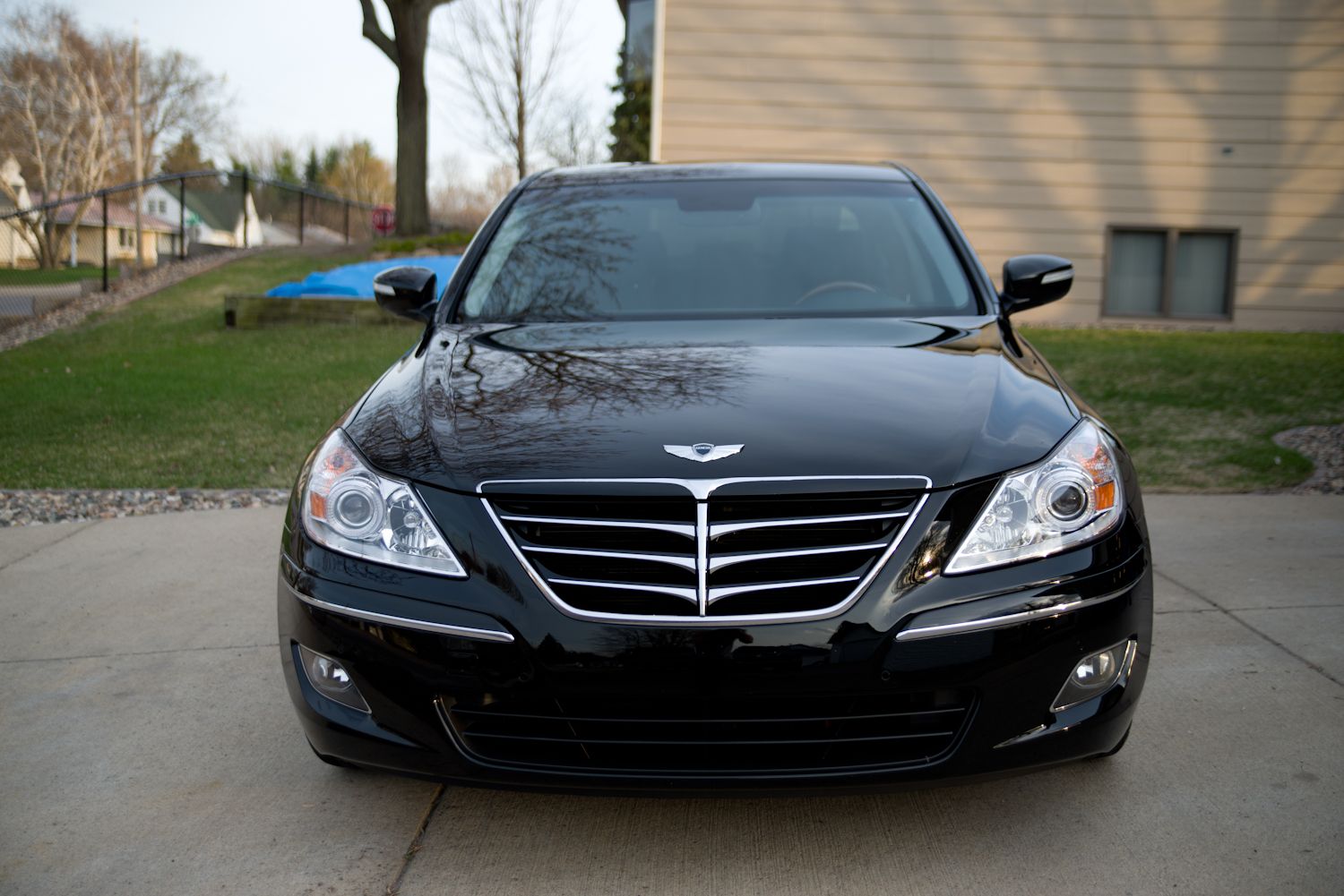

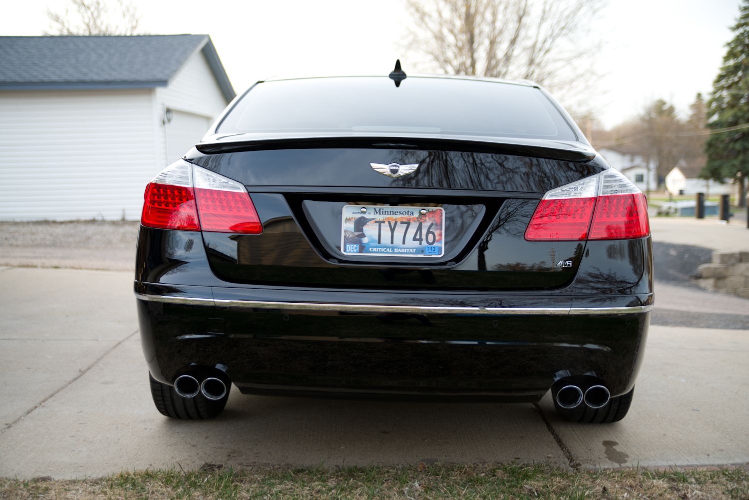

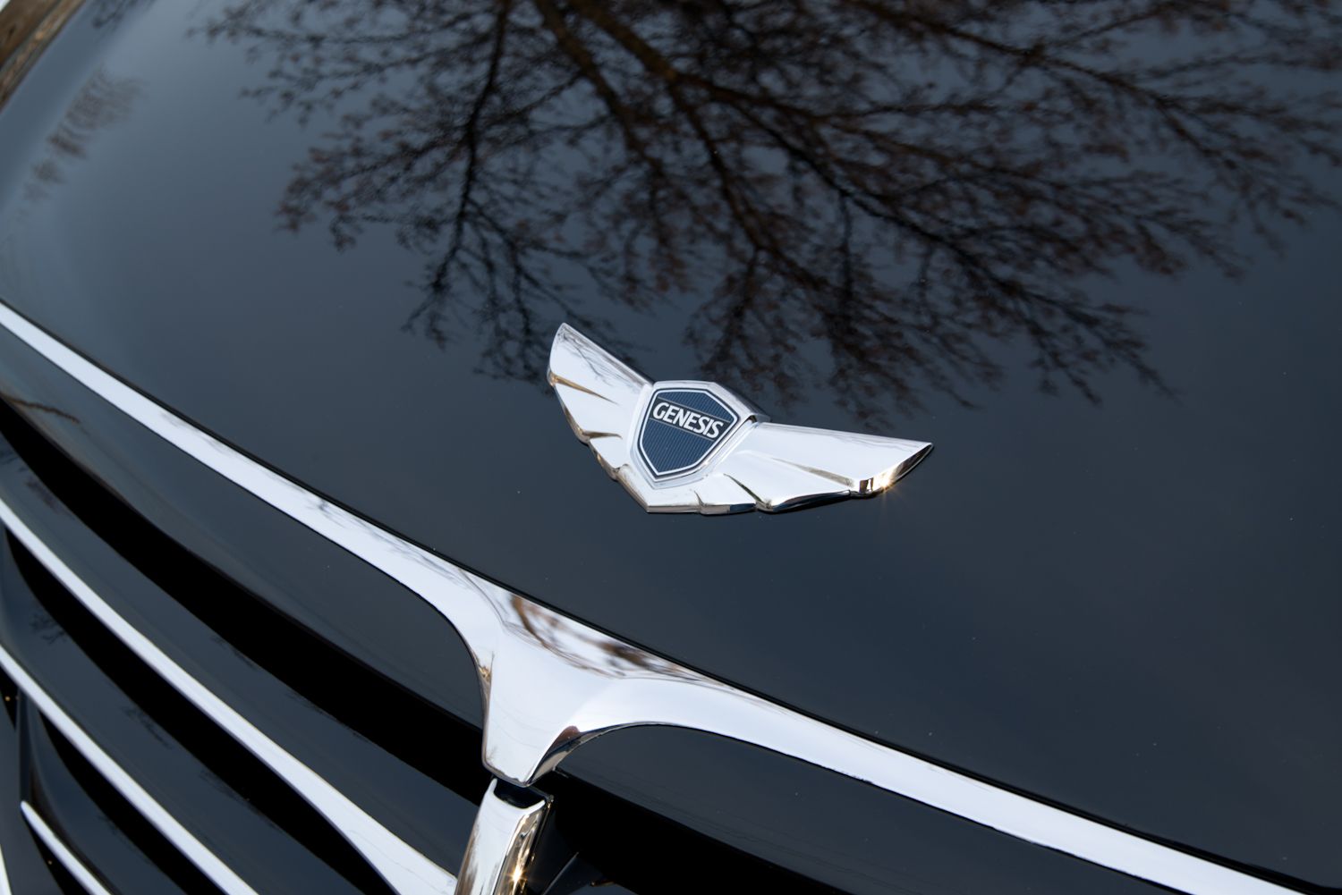

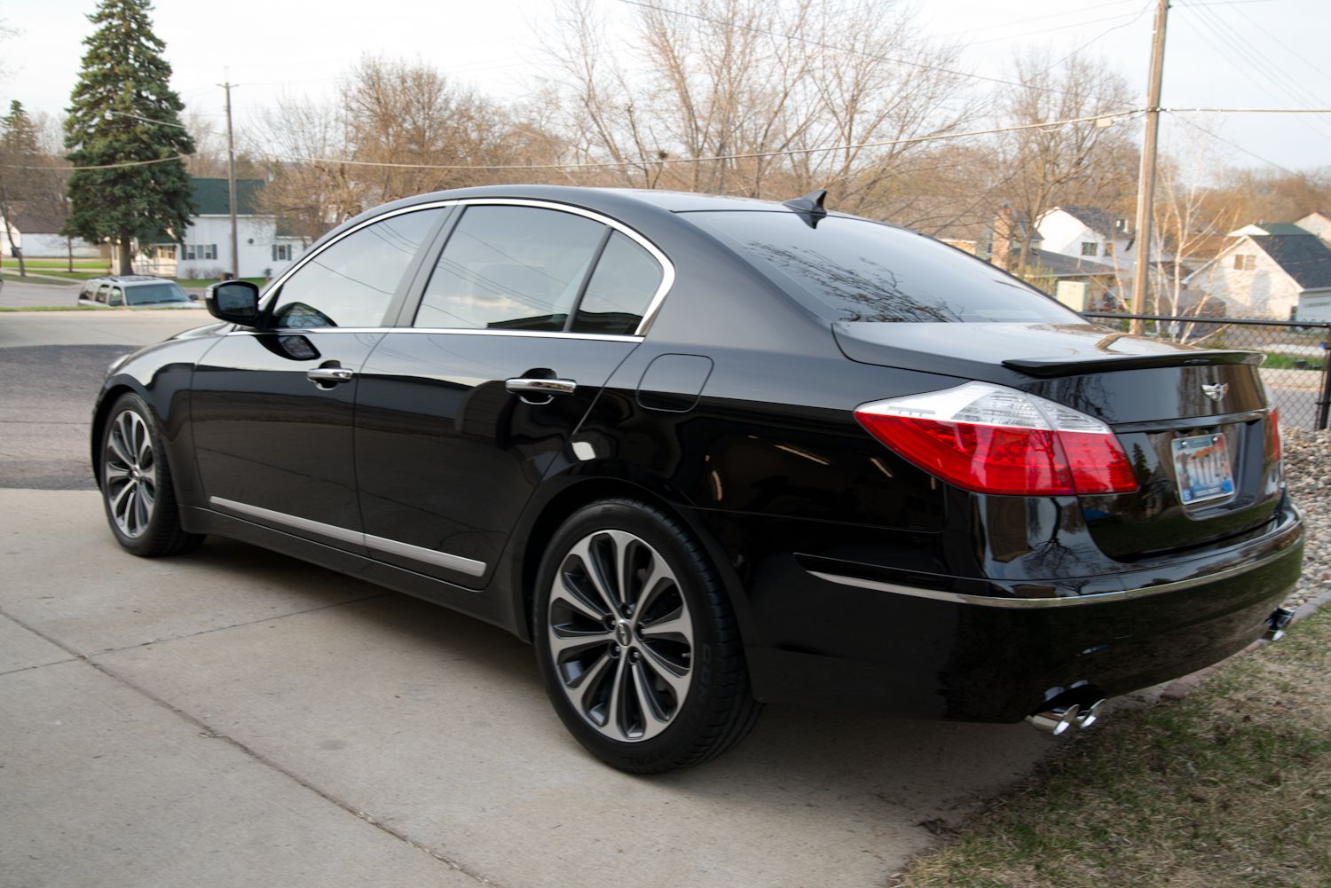

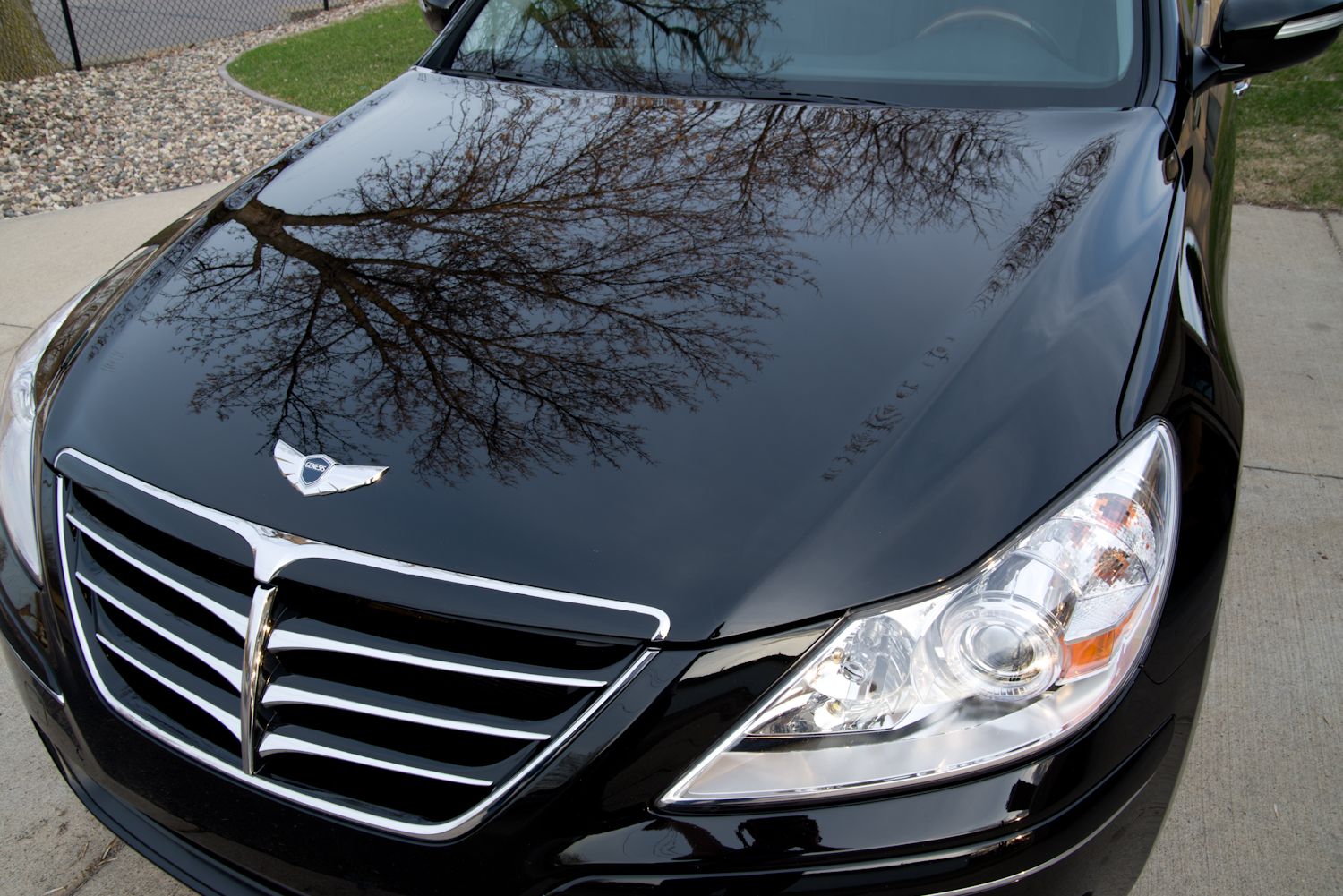

My detailer has put a thread together on autopia.org of my car before and after including steps and products used for the correction. LOOKS AMAZING!!! Here are a few preview pics Click the link for the thread.
http://www.autopia.org/forum/click-b...ml#post1502896

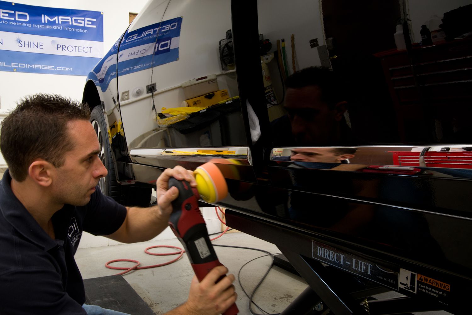

Process:
Wash - Foamed with OPC/CGCW followed by 2BM wash and CGCW
Wheels - P21S Gel and various brushes
Tires - OPC, dressed with Hyper Dressing 3:1
Clay - Blackfire Clay and M34 as lube
Initial Correction Step - M105 on the GG6 with Surbuf pads
Intermediate polishing step - D300/MF on the GG6
Finishing Step - 106fa via rotary and Blue LC pads
Exhaust tips - Optimum Metal Polish
Protection - Blackfire Wet Diamond
