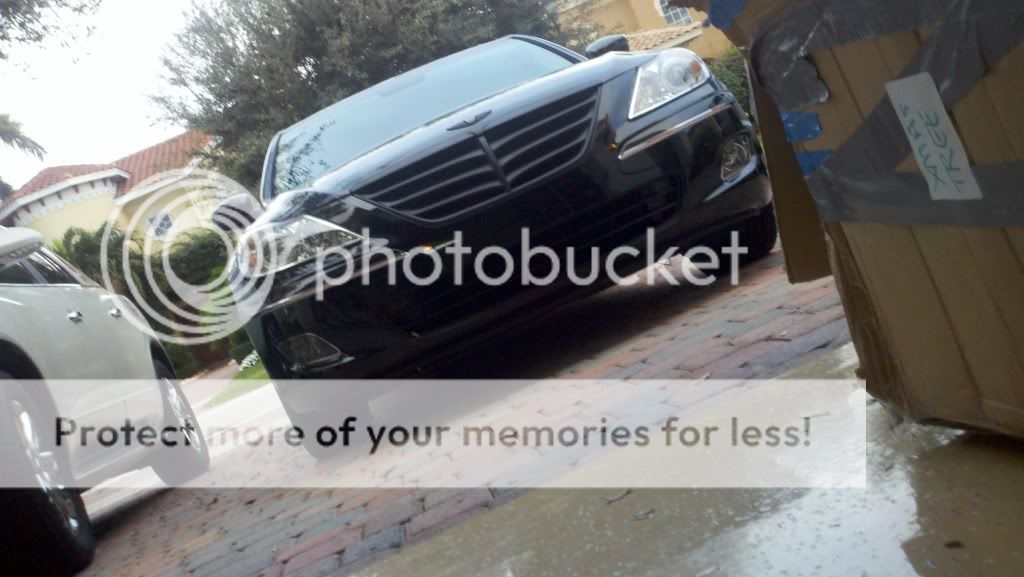

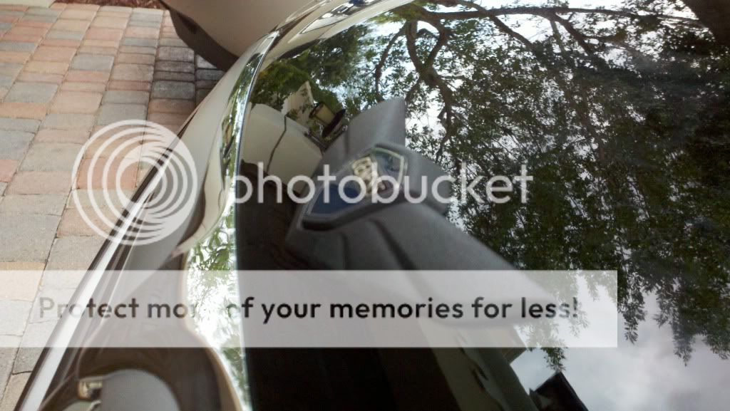

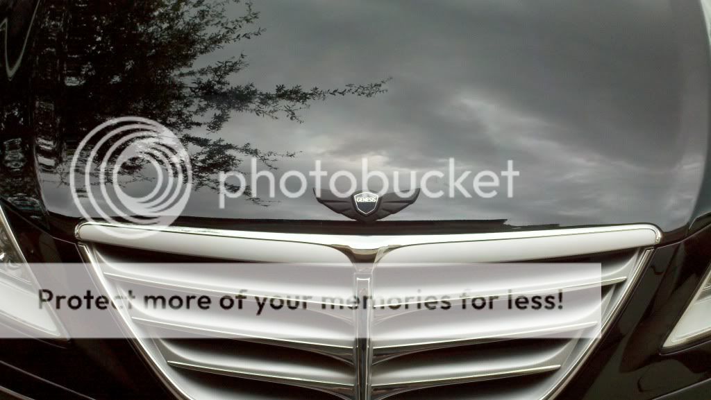

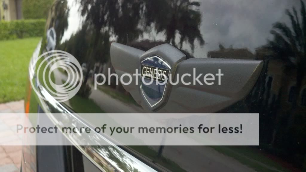

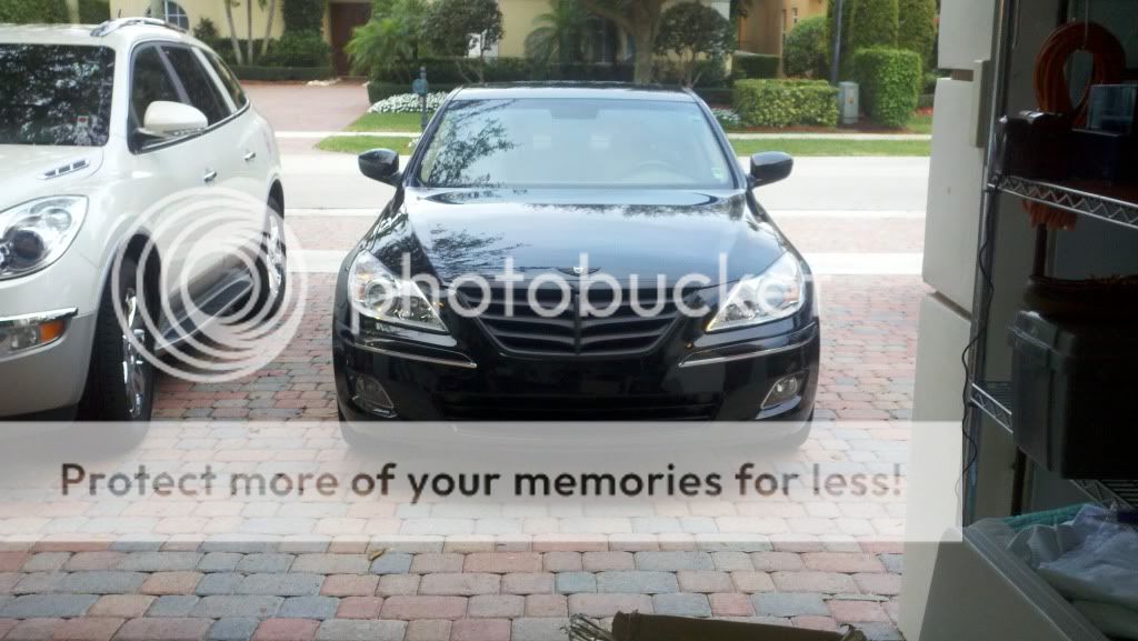

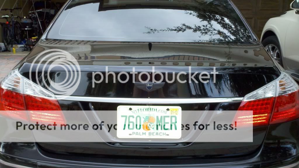

the other day i sprayed my front and rear wings matte black. for this i used plasti dip because it seems like alot of people blackout their emblems with it and its easily removable if i didnt like the way it turned out. for people who dont know, plasti dip comes in a spray can or a can and is actually a rubber and not a paint. so there is no priming or sanding, and if you dont like the way it turns out it can be peeled off.
they didnt come out exactly the way i wanted them to but for $7 it cant be beat.
the edge looks like its scratched but its just the flash

thanks. i just wish it came out a little bit darker
If you sealed it with something that gave a shiny gloss, I think it'd look even better. But a good look!

thanks. i've heard that if you spray clearcoat or any paint over it, it will get messed up somehow. this was pretty much a test run. the reason i used plasti dip is because i can peel it off anytime i want to without ruining my wings. i didnt know it was going to be matte until i was done. i will keep it for now or until i get tired of the look

thanks. im thinking about re-doing it sometime soon because i was rushing when i did it and didnt feel like waiting for each coat to dry completely, therefore its rough and bumpy. also it rained hard about 5-10 mins after. so i might consider the grill when i redo them. i was planning on getting my grill painted anyways but if this turns out good i might not.
This would look really hot on an R-Spec. The grill, front lights and wheels all have dark smoke grey inserts and that would really have a cool impact on the car.

Love the black wings, but they would be even better in gloss. That's something I would put on my car. Nice job!

Did you spray them on or off the car?
right on the car. no damage was done to the paint or clearcoat. Im going to re-do them soon because i didnt put enough coats on
How did you tape off the car??
just mask off a good amount of the car to prevent overspray. you dont need to cover up exactly around where you want to spray (as a matter of fact, this actually makes it harder and the results come out worse). this can be sprayed directly on the car and peeled off with no damage, (another reason why i love this stuff). but when it oversprays to distant areas where the coat is very light, it is very difficult to get off and required rubbing compound.

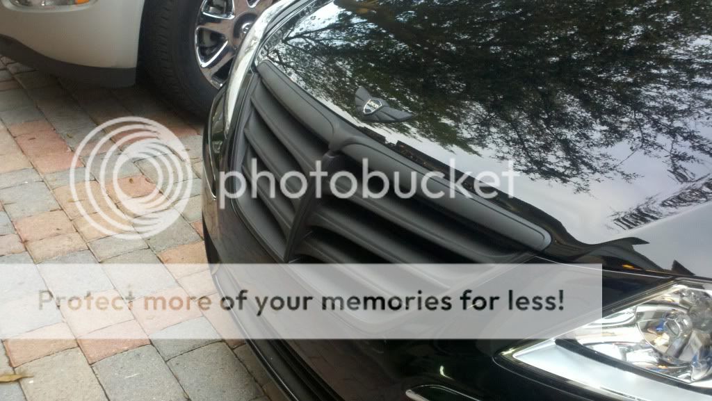

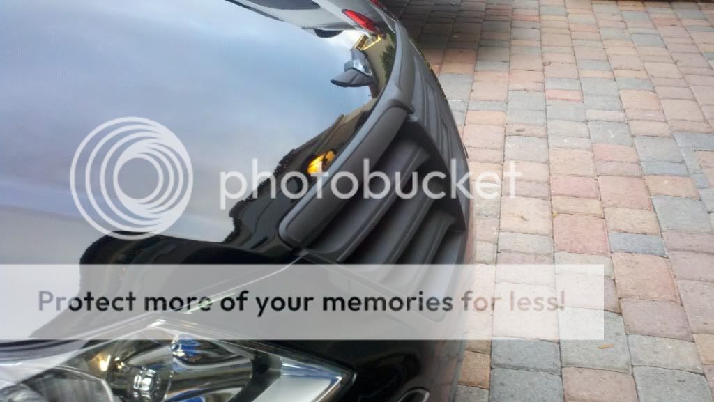

i wonder how awesome it would look if you black matted the non chrome parts of the grill to match.!
already done ;)
I actually did it about 2 months ago. i did the entire grill but i dont know if i should leave it like this or remove the parts covering the chrome. at night it looks really agressive, especially with my red parking lights on.
