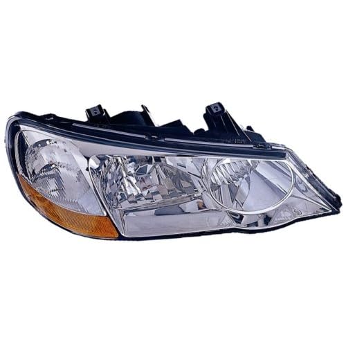

I think this is the headlight assembly for an 02 RSX.
It is sold as one unit, and is a clear plastic face sealed to the plastic rear with everything inside from the factory. It is sealed with a large amount of gooey plastic. You can cook the assembly to get it hot enough to melt the sealer without the other plastic bits, and pry the clear from the the back, to reseal it, but an easier option might be to simply remove the assembly from the car and apply additional sealant around where the clear meets the back. The whole unit should be sealed up in back though.

Yes, that was the housing. I baked it to open the seal and to color-match the chrome plastics with body color.
