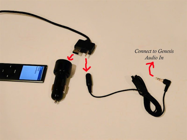

It is well known that the iPod integration of the tech package is retarded – no shuffle, and navigating through the menus is extremly slow.
After couple months of research and experiments, this configuration is the best that I can come up with. I want to share it with other iPod lovers here.

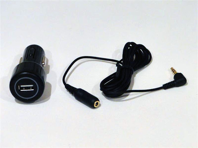

What you need are: 1) iPod Car Charger with USB connector, 2) A 3.5mm Male-Female connection cable
Here is how the connections go:
Benefits of this approach:
1) Full access to ALL iPod functions
2) No need to worry about running out of battery
3) Since the audio signal is not from iPod’s headphone connector, the audio out signal level is constant.

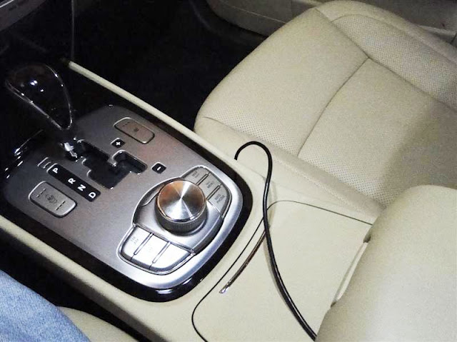

Since mine is a very thin iPod Nano, I can even just slip it between the console and the passenger seat.
Of course, only change your iPod settings when your car is not moving.

You are right. With this setup I need to keep the iPod out but now I have FULL control of my iPod. E.g. quickly change playlist/artist/album, scroll through the selection quickly. I think the key word here is "quickly". The Lexicon interface just too slow to me.
Regarding the steering wheel, I still can use the volumn up/down but not next/previous.
