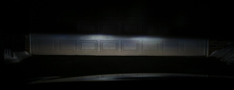

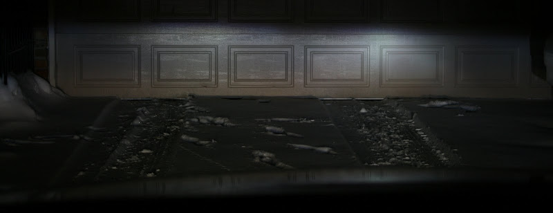

I got flashed on a trip last night so I decided to measure the beam height 25 feet from our garage (Beam should be two inches below headlight height. It was fine or if anything, a bit low...measured approx 24".) However, what I did notice was very poor dispersion...especially in the lower and side portions of the light. This matches what I saw when I drove last night. I noticed as I came up on other cars, they cast a light down at the ground in front of their cars. When I drove up next to them their downward cast halogen light was much brighter than the light coming from the HIDs.
In the garage shot, the right light seems to be a bit brighter too...or more concentrated.
I should run a beam test of the original halogens to see if they were this bad. The fog lights really help fill in the ground area. When I get a chance I'll run comparison to my '03 Acura TL which has reflector HID's.

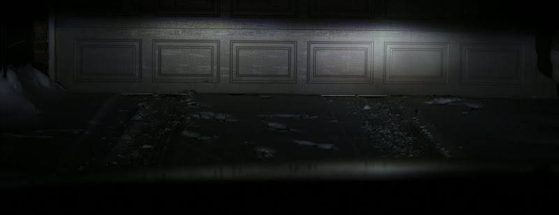

and here is with foglight fill...much better.
FYI: Camera setting for this picture was shutter speed 1/50th, aperature F5.6 and ISO 400. Taken with Canon Xti w/18-55mm stock lens set to approx. 50mm from driver's seat.
P.S. I had the car idling for about 5 minutes so the HID's should have been to full strength.
Disaster, how do you feel about placing the ballasts and ignitors in the light assembly? Do you think things might get too hot to have everything stuffed in there? I took a look tonight, but I'm not sure that I want everything crammed in there...
Fwiw, I've had HIDs in cars for years and I've been getting flashed since day one, even with stock lights set too low. Some people just think the lights are too bright and assume you have your brights on. Its the worst on my way to the beach when I'm driving through the country - those folks really haven't seen HIDs before and pretty much everyone flashes me.
As for the hot spot, I do not have that in my lights...

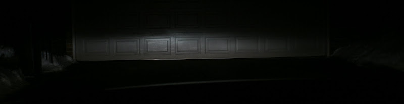

Here is the updated pics with the washer out. The first pic is without the fogs...the second with them. The car is 25 feet from the garage wall...per the standard light test requirement.

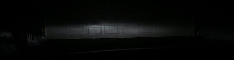

As promised, here are the Acura's stock reflector HID's. These are 7 years old so they've probably dimmed some from when they were new...with and without fogs.

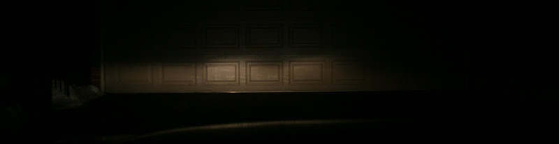

and the very pitiful 10 year old Toyota Avalon Halogens. The lens covers are yellowed which probably doesn't help matters.

I think part of the issue is how you are taking the pics - they look underexposed - its almost better to take a pic at dusk when you can get a better idea for the light spread. Either way, the HIDs in the Genesis look much brighter than those in the other cars, even with hot spots. Also, maybe you have the lights inserted upside down? Don't know if that makes a difference, but when I inserted mine, I had the 90° plug perpendicular to the ground and twisted it down as I locked the bulbs to the assembly.
Headlights in general should illuminate from ~10' to 350' in front of the car. The light pattern should drop 2" every 25'. I think the Genesis headlights should cast light up to 150°, to the pattern should be wide. I will take some pics of my headlights tonight and show my patterns.
One thing you should see is constant light on the ground from about 10' out. Fog lights typically illuminate 0-25' out and up to 180° - the purpose is low speed, low visibility, so they are to help focus on the road right in front of you.
