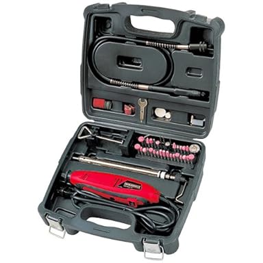

The KDM Wing Emblems come with large circular posts/tabs on the underside. In Korea the hood and trunk lid must have large holes that these can be inserted into. Since drilling on my new car isn't an option for me (or anyone I know for that matter), you will need to remove these tabs prior to installation. Short of a Dremmel Tool, I can't think of any way to safely and thoroughly remove these tabs without damaging the rest of the emblem. Luckily I was able to borrow my uncle's Dremmel Tool and it took about 5-10 minutes to remove the plastic tabs on both emblems. Once you have the removed the emblems I recommend you fill in the inner portion of of the back of the emblem with heavy duty stick tape. The sticky tape is more than enough to hold the badge securely in place, but still allows removal at a later date, if needed. This may be of importance to those of you who are leasing. Be advised: The holes in the trunk lid are not the same size/shape as the tabs on the underside of the Wing emblem. I just added more sticky tape over the holes in the trunk so that water wouldn't get in.

Honestly, it's a LOT simpler than it sounds. It just takes a bit of time and patience. The hardest part of the entire process is removing the plastic tabs, but as long as you have to right tools, it's still pretty easy. I'm really happy with how they look....they "complete" the look of the exterior. The front especially looks a bit too bare with no emblem IMO.
