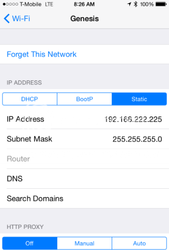

I should have put the network setup changes in my original post... It is very easy, but most responses on Apple forums are "you can't do that."
The IP address of the device is 192.168.222.224, and it starts up with a DHCP service just like any other home router. It is designed to connect to your home's WiFi for Internet access, assuming you have home WiFi. So, on the phone, you will initially see the usual DHCP stuff automatically populated.
Follow these steps below customize the configuration as a static IP.
  1. Connect to the WiFi network using the normal Apple process.
  2. Follow optional steps below if you want to change the SSID or AirPlay service name.
  3. Click the enclosed "i" ⓘ to open the WiFi network settings.
  4. Note the IP address assigned to the phone (first line) and Router IP address (third line). The Router IP address is the address of the WiFi device, mine is 192.168.222.254.
  5. Second, note the subnet mask, typically 255.255.255.0.
  6. Select the "Static" button above the IP information.
  7. Type in an IP address in the first line. I chose a high number, 192.168.222.225 to try to avoid some risk of conflict if there is another device connected in my car.
  8. Type in the subnet mask from above.
  9. Blank out the values in the Router, DNS, and Search Domains fields. THis is the important step, because blanks here are what signal the iPhone to use its own Internet connection rather than the WiFi connection.
  10. Back out, and you are done. You are connected to the AirPlay WiFi, but you will not see the WiFi symbol on the top left of your screen, because the phone is not connecting to the Internet through the device. But it works.
  11. Sweep up from the bottom edge of the phone to get the AirPlay selection option.
  12. See my screen shots below.

Great instructions!
I was able to connect to the device, and still have my phone connect to the internet for Pandora and play via this device.
I have to wait for the snows to blow over before installing in my car.. .but working from a USB connection and headphones - works great.
THANKS!
